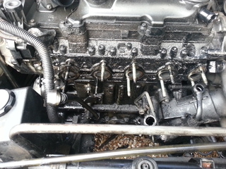

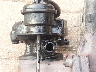

Hi all, I've just picked up yet another 1.4hdi, this was diagnosed with having blown the oil seals in the turbo before I bought it. How good that diagnosis is, I don't know. Upon inspection there is a fair amount of oil on the turbo itself and around the cylinder head. You should be able to see this from the pictures.
The symptoms that are present apart from the oil are that the car struggles to start. No problems with a bump start, just takes time to start off the key, if it starts at all that is. Once driven and under load it has a high pitched whine. It sounds perfectly normal at idle though.
I've dipped the oil twice now and it seems rather high, I've got a feeling that it may have been over filled and the oil in the engine bay is what has been blown out of the breather. On starting today I did get a puff of black smoke from the exhaust. I've examined the cat and that is oil free, as are the exhaust manifold ports and the intake side of the turbo.

if the turbo seals were leaking there would be oil in the manifold/s,
if the oil level ids way to high it will almost certainly push oil out were ever it can ( oil seals , crank case breather and dip stick tube,
deal with the high oil level fist,
you might find the oil around the outside of the engine is either from the rocker cover gasket or the turbo oil feed union

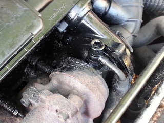

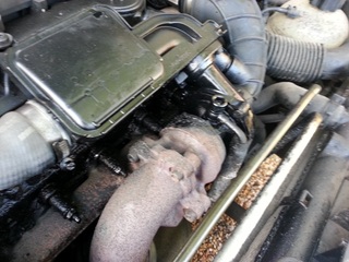

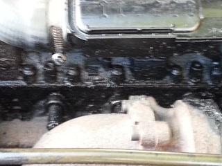

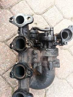

Thanks for the quick responses. I'd already made a start at stripping the manifold/turbo off. I've another few pictures of the state it's in. I'm definately thinking it was an over fill, and the oil is about to be dropped now. At least with it like this I can give it a bit of a clean up :)

I've drained just over 4 litres out of it. Not bad to say it's capacity is 3.75. Possibly blown around a litre or so around the engine bay so I'm really hoping it was just an overfill. Time to clean it all up and then give it a service. Next step is checking the fuel pressures as recommended.
