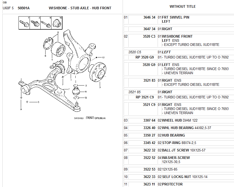

spider
Posts: 3949
Joined: 05 Jan 2010, 14:28
x 77
Re: 806 osf stub axle
Unread post by spider »
I think its 806 specific although Expert will be the same as well as some Citroen models.
Slight chance its the same as a 306 but I doubt that.
Andy.
spider
Posts: 3949
x 77
Here:
Andy.
