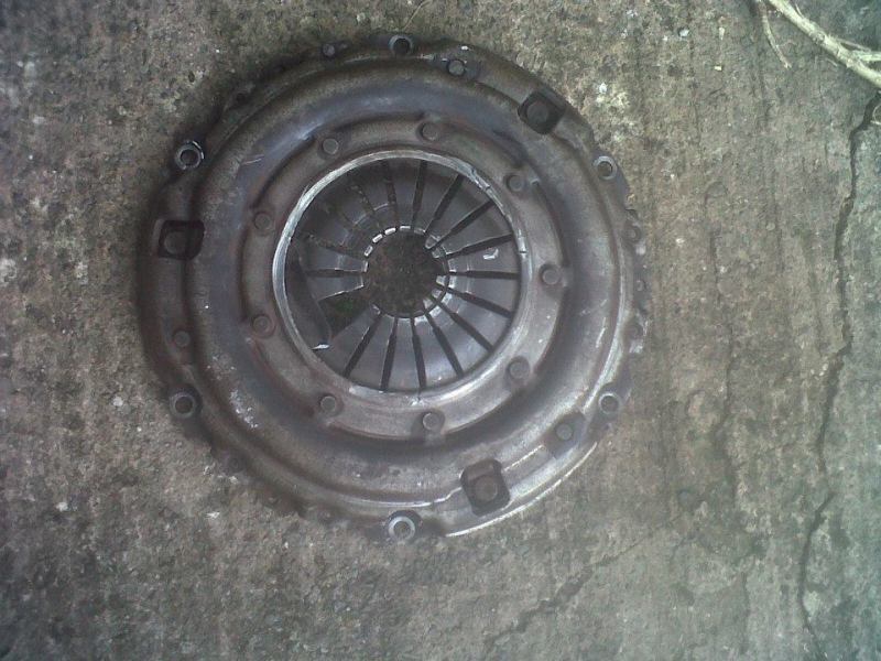

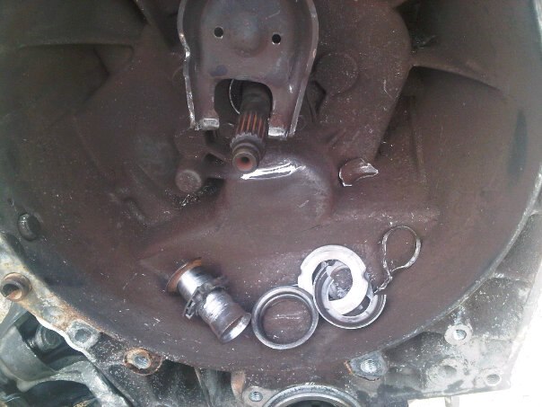

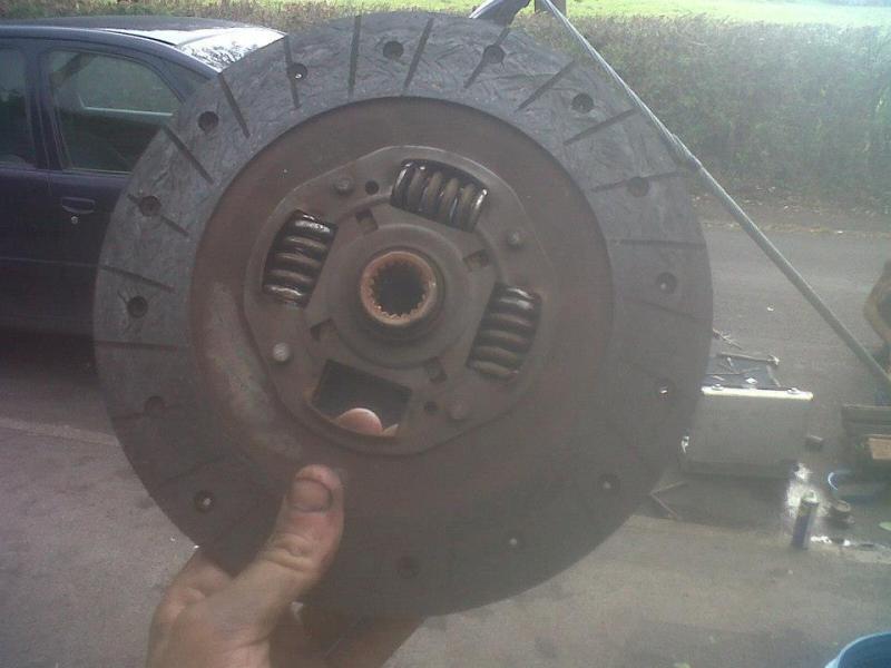

hers are some pics of what i encountered when i initially pulled the box out

just read you post properly,
if those picys are what you found when you first dismantled it, it looks as though the thrust bearing had worn through the pressure plate fingers, then smashed the thrust bearing and guide tube

You have got the friction plate in the right way round....???

Im really greatful for all the replies and advice, I decided today to ignore my amateur mechanic friend who has been helping me alot in getting this sorted....he bolted the clutch up against the flywheel the other day and stupidlyu i assumed he knew what he was doing....obviously not, bloody friction plate in the wrong way round, i removed the box alone today, turned the plate around, put it all back together and it now drives perfectly.......i guess the saying "you pay peanuts , you get monkeys" is true....thanks again gents
