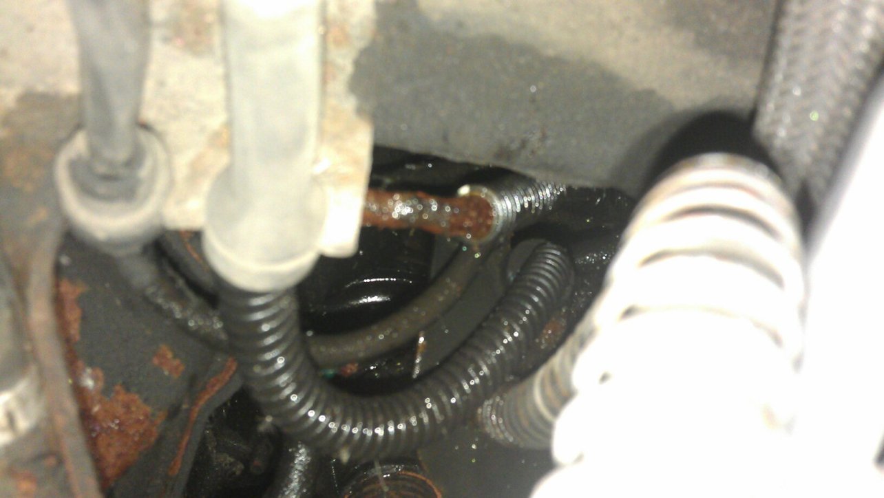

Went to move Juliet tonight and found that the metal pipe visible through the wheel arch is rusted as heck and LHM pours out of it.
I can't see where the pipe goes.

That'll be the PAS pipe Xac, a well-known weakness on the MK2.
Now NFP so it'll be a case of having a natter with Martin I'm afraid...

Any idea what the likely cost will be?

Give him a ring, he may be able to put a joiner in or repair it as the whole pipe has a high pressure flexi section in the middle too................
