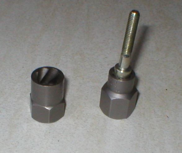

That kind of locker can often be got out fairly easily using a reverse flute socket indented for the removal of badly rounded-off nuts. Irwin make a kit of them in various sizes..
This is one, shown in use...
I have used one on an identical wheelbolt with perfect success...

Thanks for that, CitroJim. We have a set of those kicking about the workshop so I'll get some new bolts and fire up the compressor.
Violence about to comitted! :twisted:
