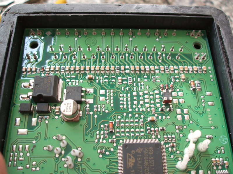

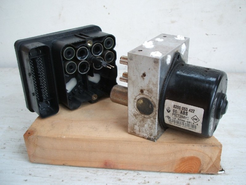

Now here's a bit of a story for you and a few pictures....

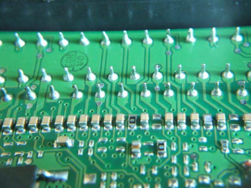

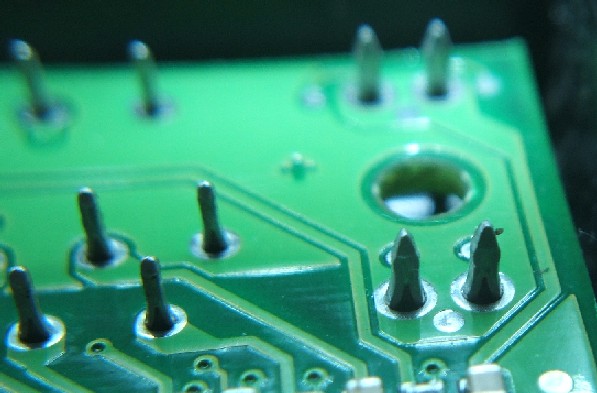

Once I removed my old ABS unit I took it to bits, I've read that the problems come from the ECU part of the unit, this part is replaceable on it's own, figuring I had nothing to loose I cut open the ECU to see what was inside.
I found that the pins on the circuit board are a push fit pin, they aren't soldered they are just pushed into a hole and this makes the contact. This technology is now being used on lots of things. The pin has a head on it like the eye of a needle so in theory when it is pushed into the solder lined hole on the circuit board it makes a nice tight contact.
I'll not rabbit on about it but I've researched this push fit technology & I can tell you that there are people in the industry saying that it's not as reliable as the manufactures would have you believe.
Why am I telling you this...well if you're up for a challenge and the old ABS ECU is just going to get thrown out it may be worthwhile cutting the lid off of it to see if your ECU has the push fit pins also (Very likely) if it has you could solder them all as I have a feeling that the units are failing because of bad joint on the circuit boards, I would love to be able to tell you that it will work but I haven't actually tried my soldered ECU back on my car yet.
I did solder each pin / joint on my ECU but as the ABS unit is mounted behind the front bumper in the N/S wheel arch it means that the front bumper has to be removed to get to it and I just haven't had the time to try it, I will try it at some point as I would like to know if my thinking on this is correct.
So if you fancy having a go at it and posibly fixing your problem and also proving my theory, I'll give you as much advice as I can.
Cheers.
Here's some pictures for you.
The ABS unit, The Motor, Valve block, & ECU.
Inside the ECU showing the push fit pins
Close up of push fit pins
Showing the soldered pins
I must admit I didn't think I was going to be able to just fit a 2nd hand ABS unit to my Laguna without having to have it plugged in but it worked and as I say others have done the same.
The reason I asked if it was an ATE made unit is because that's the same make as what the Lagunas use.
Cheers.
