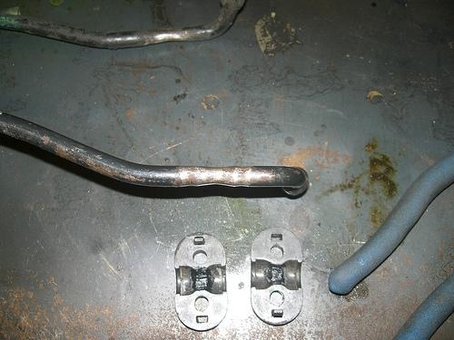

CIMG3646 by Deanxm, on Flickr
Dean how do you fix that?
I hava new bushes but my rods are the same :/

You need to replace the rods too. That then gives you the fun job of re-adjusting the roll!

Xac wrote:You need to replace the rods too. That then gives you the fun job of re-adjusting the roll!
I did not want to read ...
The rods cost a lot of money:/

If your half handy with a welder you could build them back up and grind them back to shape, easy enough to do it just takes time. I built the old blocks back up by plastic welding some more material back in too and they worked fine, ive got them sat by as spares now for the cost of a couple of welding rods.

I don't remember them being that expensive...
