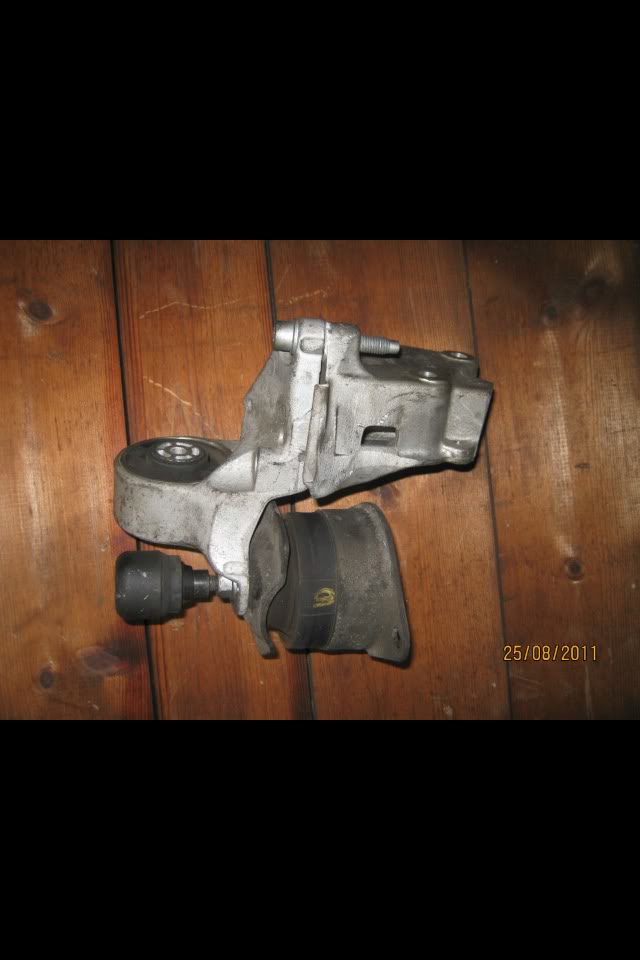

Which bush would have gone if the engine is rocking back and fourth?
Pic from eBay.

Nothing on that picture
There's a link that goes from the bush at the top right to the inner wing - it is the bush in this link that breaks up.
