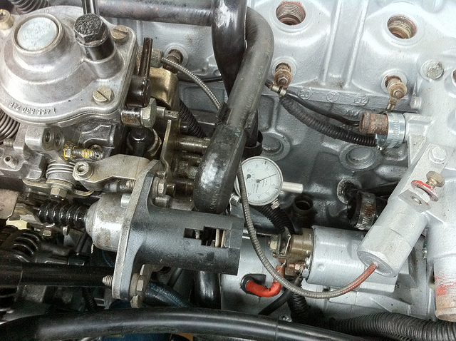

Here's how it's done with dial gauge.
Steve.

Hmm, what's the dial gauge measuring then? I suppose it would be checking TDC of the main plunger inside the pump against a timing mark on the fly wheel and working out the angle it should be at from that? - or summit :/
Anywho, I rotated the pump back so there's no knocking (sounds smooth and quiet), but I'm back to more smoking and hunting :(
I'll have to rotate back to knocking and look up what's going on and the best way to improve matters. ugh.
