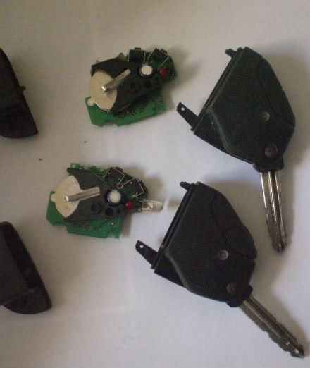

I've done it before, but is there a thread which has the instructions for "reprogramming" the plip?
I have two plips which need reprogramming. They are from a 1.9td L-Reg Mk1 and IR I presume.
Thanks Neil
Thanks Neil
