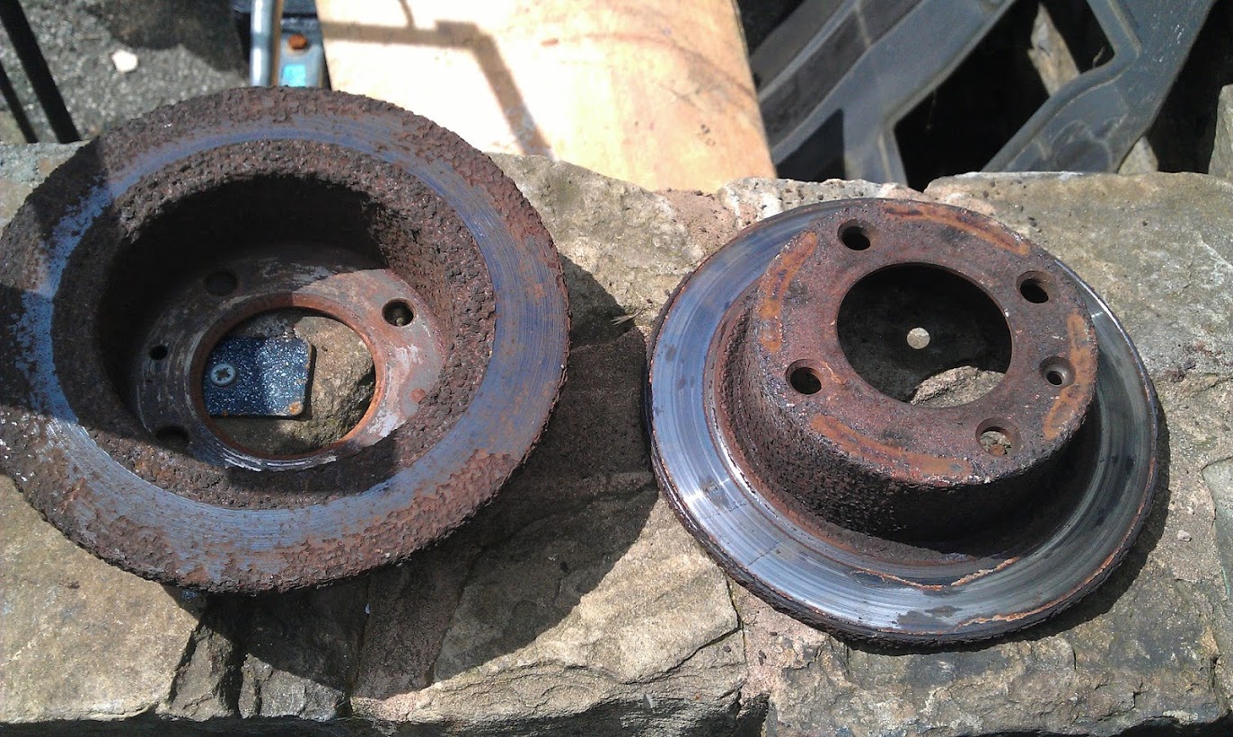

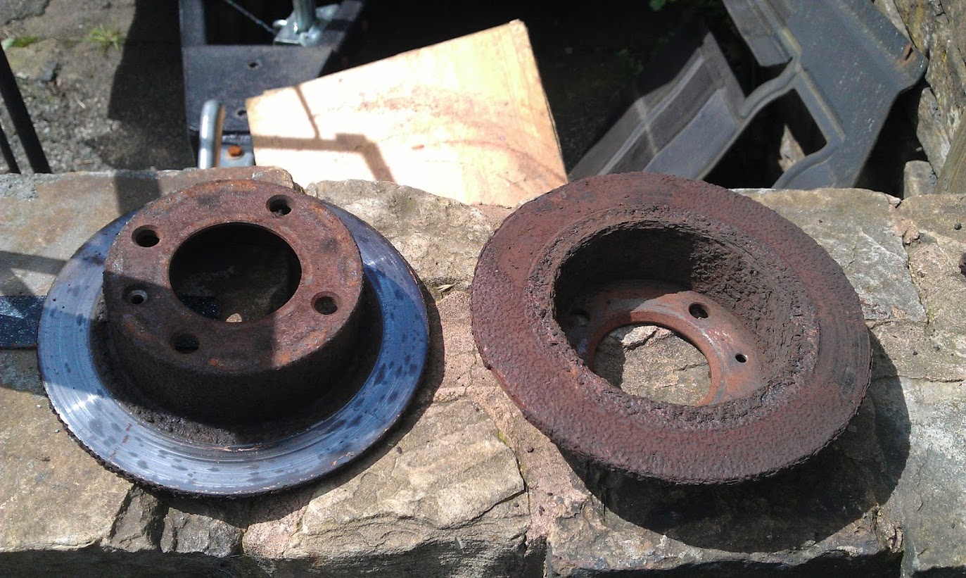

I just thought I'd show you the state of my rear disks, the calipers are well oxidised and I'm swapping them over.

That's impressively bad! Mine were, surprisingly, serviceable - despite changing out the original pads at 130k!
I was trying to convinve my self that the NS pipe was not leaking where it went in the caliper, but it clearly was weeping - and sure it had been before I messed it around. No doubt the OS will follow suit soon....

RoadkillUK wrote:I just thought I'd show you the state of my rear disks
Bloody hell :shock: :twisted: :lol:
Makes mine look positively immaculate :roll:

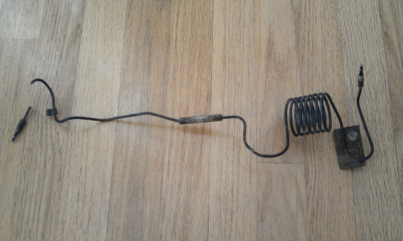

I got my pipe this morning, not fit it yet but I have been busy bending it to shape, I've done the 2 ends and I'll make the spiral when I find something that fits :)

superloopy wrote:
RoadkillUK wrote:I just thought I'd show you the state of my rear disks, the calipers are well oxidised and I'm swapping them over.
:shock: :shock: :shock: MIne were nowhere near as bad as that, how long have they been on I wonder? I live on the coast and expect a smidgin (?) of corrosion, but bl**dy hell, i am quite shocked that any car could be on the road with brakes in that state.
I've had no reason to take the rear wheels off since I got the car, I wrongly thought something like that would be noticed on the MOT :)
Here's a pic of the new pipe and I'll soon have it in the car (tomorrow).
