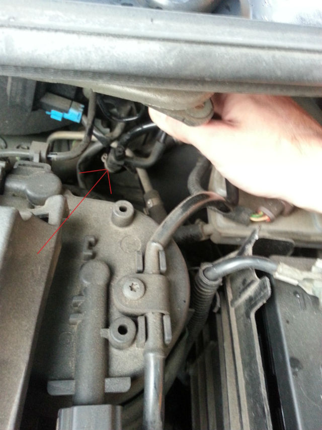

Just been out and took a second look while dodging the rain, it wasn't the air filter ducting. It was a small vaccum hose which goes over the fuel filter which has a hole in it. Will repair that tomorrow. Attached a picture of the offending item.

any vaccum leaks can stop the turbo working

Had the fault codes read this morning, accelerator pedal came up several times! Swapped it with my other one and the difference in travel is unbelievable, pulls a lot better now but I think it still struggles to pick up sometimes. Vacuum pipe was for the brake servo, brakes are a lot sharper now for sorting that out.

even the servo vaccum pipe leaking can still affect the turbo
