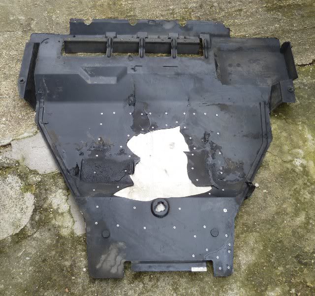

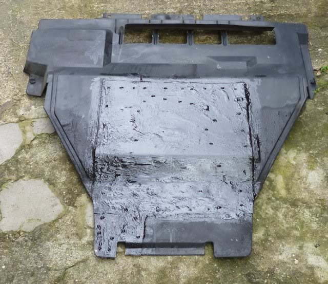

You can work wonders on a broken undertray with a pop riviter and some ali sheeting. On the only time I drove my previous Xantia for a few months without its undertray I did lots of damage to the wheel liners because they were able to thrash about in the wind.
This is our Xsara's untray which dropped from its rear fixings.
