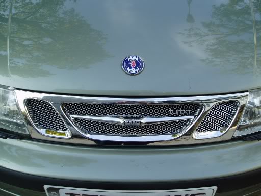

£100 for some large diameter chicken wire! We used to do our Saab grills with £8 worth of wire from B&Q to great effect.

That stuff is from B&Q!!! could use that and get some chrome edge stuff to finish it off.
For the C5 it would have to be cut perfectly, not sure I am up to the task.

Its not that difficult, make paper templates and leave a couple of mm extra all round to bend into the sides. You can either use small blobs of gasket sealant on the reverse side to hold in place or you can even buy small silver zip ties to secure either side.
