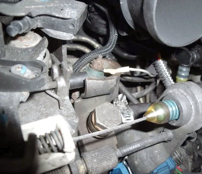

Re: ZX diesel Immoboliser Problem
And here is the pic, I knew I had it somewherespider wrote:... looked like they angle ground into it and just cut some of the "top" off to get at the solenoid, but left raggedly sharp edges.
Its a DW8, usual Lucas pump:
Not mine, I had the pic for a while not 100% sure where it came from.
Andy.
