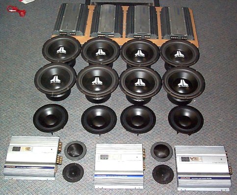

Just a thought for the really keen owners.
One of my sons is a qualified I.C.E. sound system designer/fitter for Alpine Stereo systems.
He has access to a lot of stuff readily available & although at times expensive, sometimes it's cheaper than constantly replacing the lower quality stuff. When he fitted his sound system to his CX a couple of years back, the power draw was such you could have welded with it so he had to take drastic action & arrived home with new battery cable and 24crt Gold plated terminals. They weren't cheap but he transfers them from car to car as he buys.
For the record, this is what it was powering which is testament to their ruggedness.[:p]
Alan S

Yes Jeremy, that kind of thing only I think his had a bolt on clamps for the wires; very well made & the type of thing you change car to car. At the price you nearly have to take them with you.[:p]
Alan S
