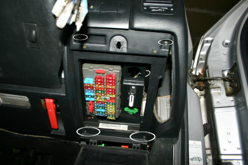

To begin with, move the seat back as far as possible, you're going to need the space, open the document storage area and remove the 4 screws inside,Image

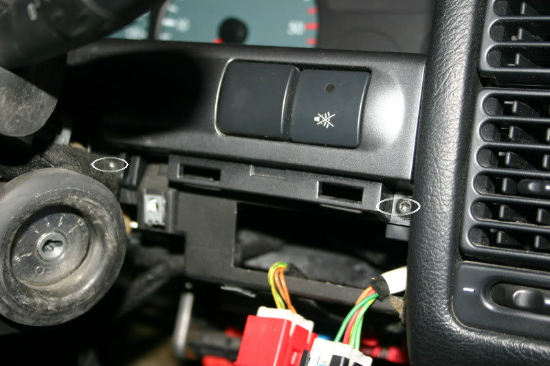

you can leave the (carpet trim attached to the bottom to save time) and remove the single screw attaching the switch assembly above.Image

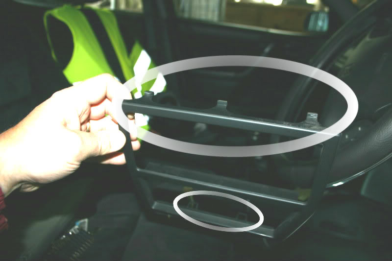

On the next panel, there are two long screws hidden in the holes immediately under and infront of the steering wheel which hold the trim above and below the stering wheel in place, Remove these and both parts of the steering wheel trim can be removed. (caution the courtesy light needs to be popped out of the housing, and the dimmer switch also needs to be disconnected)

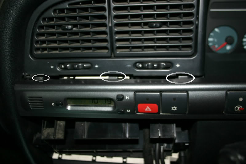

The heater/radio trim is now held at the bottom by two slip on clips and at the top by three push in clips
Gentle pulling will release them and expose the radio screws either side of the radio.

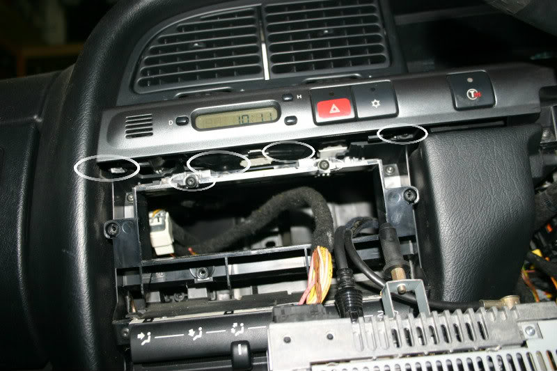

Just above and below the radio the four radio housing screws need to be removed. Again the housing can mostly be left in situ, just pulled forward to acccess the screws above and behind it.
All four of these screws need removing, two holding the clock and two slightly hidden at either side at the top of the opening holding the facia bar.
Now work along the facia bar and remove the remaining screws, one on the left of the steering wheel one on the right and the last one on the far right.

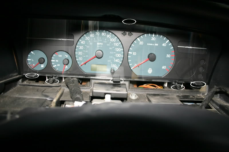

You now have access to the speedo.Image Two screws on the bottom left and right and one in the center at the top of the unit. after removing these, the easiest way to remove the unit I found was to ease a flat blade screwdriver under the tab at the top of the unit and allow it to fall forward and then the unit can be withdrawn. (take care not to loose the three square mounting rubbers which slide on to the three lower locating lugs on the bottom of the speedo. I removed these and left them in the empty speedo space ready for reassembly)
There are two electrical connections at the back of the unit and two cable holders holding both cables in position. remove the cables from the holders and now the speedo unit can be twisted to access the rear and enable the two connections to be removed. (The black release bar on the connections clicks when fully open and closed)

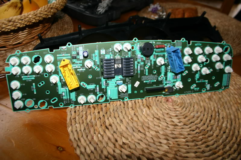

    [4] Removed speedo head looks like this (8695, 8696)
    [5] Examine the printed circuit board
    The likely culprits are one of the four soldered posts. The broken solder on
    one of the pins can clearly be seen in the photos. The pin was loose on the
    circuit board.
I used a touch of solder flux and a 12w solder iron and the original solder
just jumped back into place!
