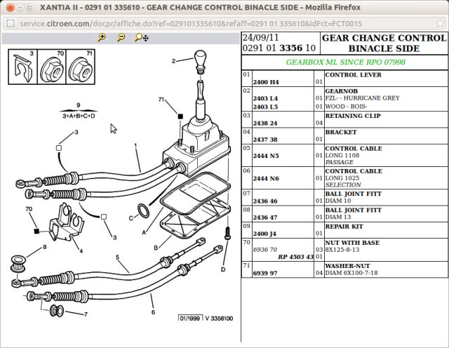

Yes, stretched and playful cables can cause problems in engaging gears. The cables can be replaced individually but it's a heck of a job as it needs the exhaust to be dropped and access at the gearbox end is not exactly wonderful...
Here's the parts in question:
Changing an ML5 gearbox on an HDi is a nightmare (due to its size, weight and room) and expensive too as the clutch MUST be replaced at the same time as it's a fit once affair,,,
