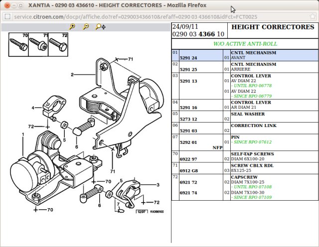

Hi, Guys, does anyone know the proper name or part no. for this "the small anti roll bar bracket which attaches to the dog bone on the front height corrector. The bar that comes off it that the dog bone connects to was deformed and bent so not in its true position."
My forte estate has always been slightly high at the front and has lifted at the front when turning into parking spaces for a while now.
Cheers, Michael
Posts: 55162
x 8428
Re: Xantias "jumping" front ends - solution !
Michael, it's called a 'Control Lever'
Here's a page from the parts list:
Note that there are differing diameters of Anti Roll Bar which affect the part number of the lever. Those illustrated are for the 1.9TD hatch. If you let us know your exact model the correct part numbers for your car can be advised...

Hi There, thanks for the reply. Mine is an 01 (on an x plate) xantia forte 110 estate, cheers, Michael
Posts: 55162
x 8428
albertz78 wrote:Mine is an 01 (on an x plate) Xantia forte 110 estate, cheers, Michael
OK, this evening I'll get the picture up specially for that one. It will be different I expect...

Same picture, but estate looks to use a 23mm Dia roll bar on the front, so the part number is 529114 - price is the same at £28.88
