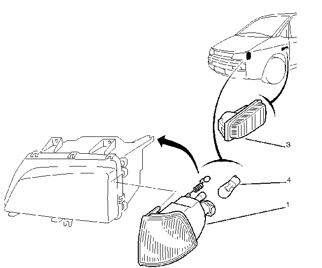

Quick part numbers for now and pic / key below (double check though I've not mixed them up)
Early (left) 630325 - up to and including 8000
Later (left) 630373 - 8001 onwards
Early (right) 630326 - up to and including 8000
Later (right) 630374 - 8001 onwards
Build code should be on door / a pillar area / under bonnet on strut tower. '98 is one of the first though, I'd be surprised if it was the later units unless its had later headlights (and changing those might involve changing the front panel etc, not looked into that) , I think 8001 is the slightly 'facelifted' shape one tbh.
One confession, I'm not 100% sure if they are judging left right from standing in front of the car looking at it or from the perspective of the driver sat inside it...
