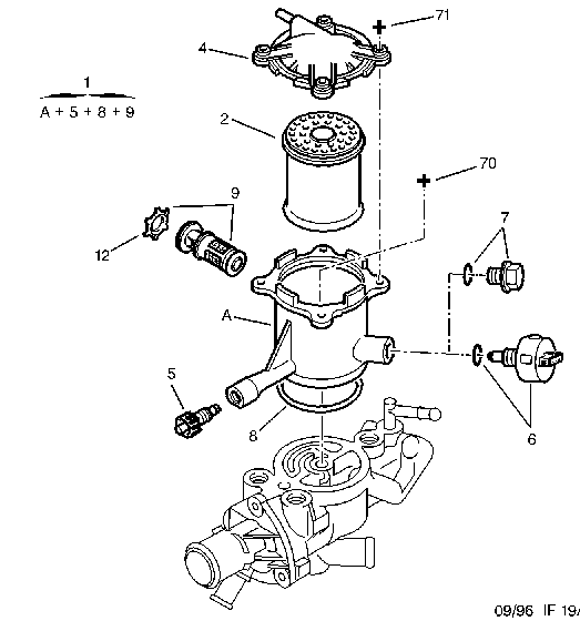

Peugeot part numbers:
The blanking plug instead of the switch (not needed for yourself I know, but I'll post it in case it helps someone in the future via a search) 191715 is item number 7
The actual "I can haz water in fuelz" (sorry) sensor is 191305 is item number 6
