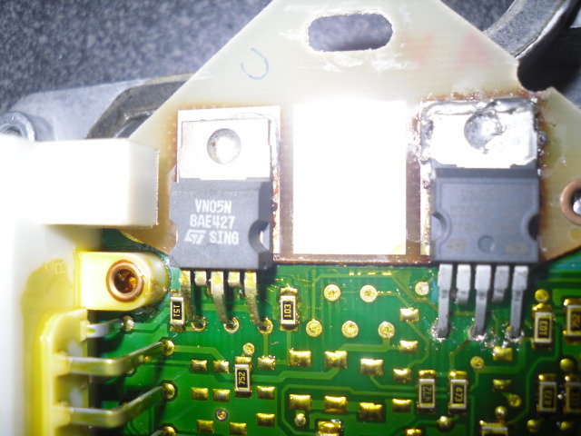

Thanks John, I think I will take you up on the ECU offer, unless anyone has 5l of petrol and a lighter?
I took the ECU apart this afternoon and all looks fine since the Vn05n replacement and diode mod.
Replacement chip is on the right, I left the other one as it looked fine

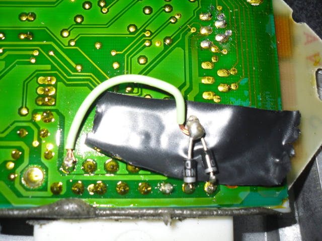

Here is my internal diode mod from a while back.
All looks ok

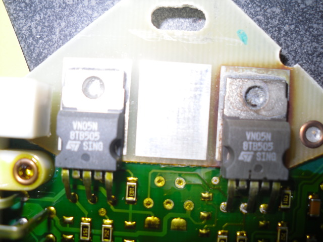

I also took apart the ECU of the estate out of curiousity
You can see that exactly the same thing has happened the chip on the right looks to have been getting very hot, this is more apparent when looking at the other side of the board where it has sort of delaminated it a bit. So although this doesnt look completly blown I Think I may replace it anyway, and do the diode mod to this one as well.
