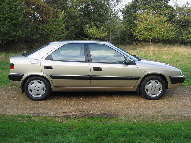

Re the ride height, does the car look reasonably "normal" when the engine is running and when you get in/out of the car does the height correct within say 15-30 seconds?
This picture of my VSX gives you an idea of what "normal" ride height looks like.

Bloody hell! That looks a very nice example Richard.
Yes. It all operates correctly.

It's been rather cosseted throughout its lifeRhothgar wrote:Bloody hell! That looks a very nice example Richard.
The new sphere's you fitted, do you have the make and model of them? I'm wondering whether they are of the correct spec.

It shows Richard, it feels, looks and smells like a new car, stunning example.It's been rather cosseted throughout its life![]()
