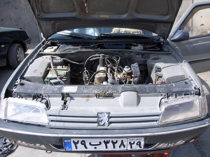

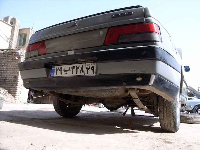

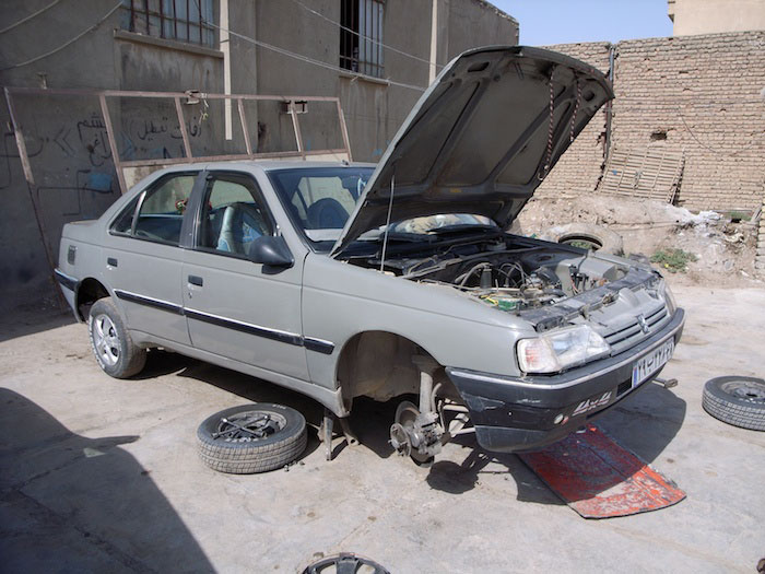

Rear wheel drive with XUD power? Put the engine in one of these, you know it makes sense.
