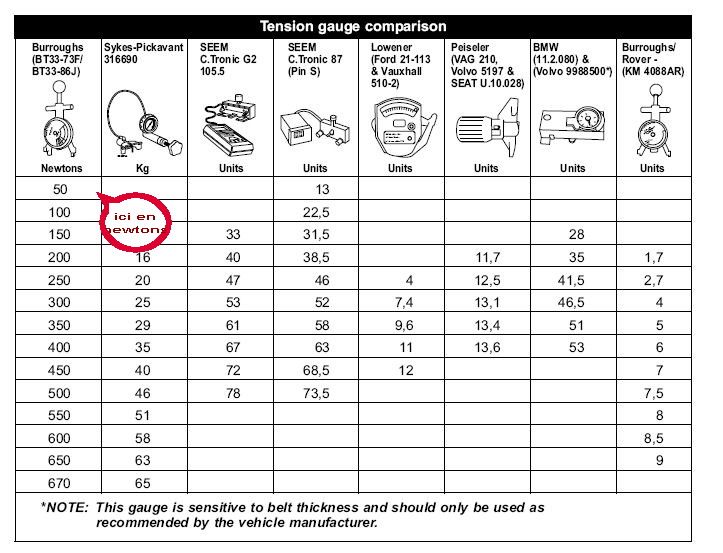

I (now) have one of those KM gauges although its not in SEEM's as expected and I am unable to find a conversion table.
Andy.

Thanks Jim that may be of a great help.
I'm just sort of planning ahead really and I saw the tool reasonably cheaply (I hope!) and brought it, figuring it would be useful in the future.
I think mines in lb's , although not sure if that's different UK vs US or not, something I'd have to check as well as a quick conversion between pounds / lb's and Newtons or KG's.
