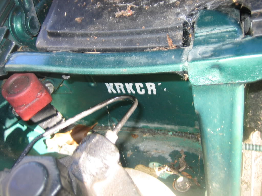

Its worth also hitting the fuel cut off button if it has one. Check behind the drivers side strut top in the very corner.

Thanks Steve, I told the owner that, he only wishes he had done it before now :lol:
