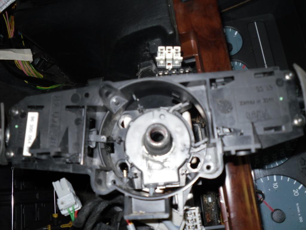

OK time for todays stupid question.
1) remove airbag - check
2) remove radio controls - Check
3) Remove clock spring - Check
4) Remove wheel torx bolt - check
5) Steering wheel removal - Check
5) Disconnect electrical connections for indicators and wipers - check
6) wiper/indicator switch removal - Fail
There seems to be a grey/green box in the centre of the wheel that is stopping the switches from being removed. (Its not on an S1, as I changed the switches on that last week?).
How do I remove it, or even just get the switch's off.
Thanks again.

Both wiper and lights stalks have two torx screws. You need a T10 key to remove them.
I couldn't see the picture link given by you. It seems that my browser doesn't
convert/interpret the "space" characters in the picture name which are seen as "%20".
May be you should replace "space" for example with "_" character.
Anyway here's a pic from my car when I replaced the wiper stalk.

Pic attached as an upload.
Have been trying to remove the whole unit. Did not realise that you could just remove the one side........
