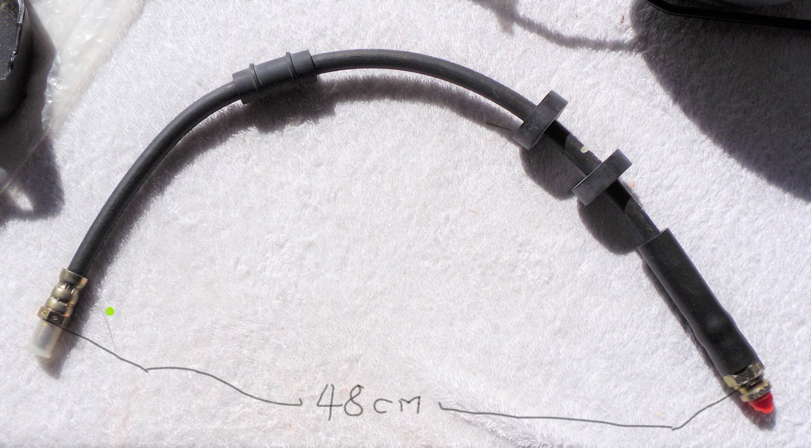

Trying to find what this fits so I can stick it on Ebay.
It's a new flexi brake hose in a Citroen/Peugeot bag, part number is 4506.FP, I can't find it on the cloned parts list disc and the new boy in the Citroen dealers couldn't find it on his computer.
So is it a discontinued number or maybe a Peugeot part, gawd knows?

That's what I've found Addo but nevertheless the part came as part of a job lot from a closed down Citroen dealership and it's physical presence is sitting here on my table so it does exist.

Here's some pics:
Overall legth is 50 cm 480mm approx. between the flange faces.
Has inscibed along its length Hutchinson SAE J1401 1/8" HL 9078 E/E DOT.

what does it look like down the boar of the large/top end,
can you tell if its intended to take a hydraulic type metal pipe end, or is it for a conventional flair
also i don't recognize that rubber sleeve half way down it,
regards malcolm
regards malcolm

Conventional flare as in Lockheed /Girling

as in non hydraulic citroen,Gibbo2286 wrote:Conventional flare as in Lockheed /Girling

Yep!
I've been looking at some of the numbers and it seems that most of the brake hose numbers commence with 4806 not 4506 so Ive had a close look at the part number on the bag and it's just possible that the number has been rubbed enough to have turned the 8 into a 5.
I still can't find a match on the cloned parts disc for 4806FP or FR though. 4806F9 comes up as front for a C6 and 4806F0 as front for a C8.

Back to the clearance, this part is still here.
The label numbers on the pack is rubbed out a bit but I think it's actually 4806F and a number one to nine,
I can find it fits either front brake hose for Relay or C6 on Service Citroen,
