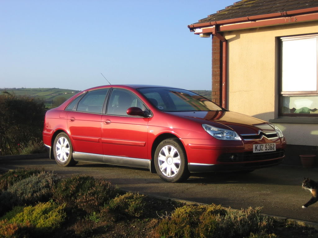

My overall impression of the serviceability of the C5 has improved even more since I did the job, I am really impressed by the easy way it comes to peices and yet nothing rattles, the sound proofing on the doors is quite elaborate but very simply executed. The C5 is growing on me.

Sound slike a good job Peter
Im glad, they are pretty good cars.Peter.N. wrote:The C5 is growing on me.
