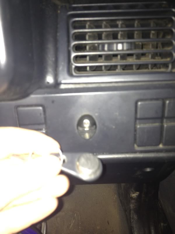

Here's the immobiliser if that helps, I'm holding the button that I press to it to deactivate it.

I'm sure the light on the wheel is the airbag check light. It should go out in a few seconds once the ignition is turned on. If it doesn't come on at all, there must be another fault. Worn ignition switch perhaps?
