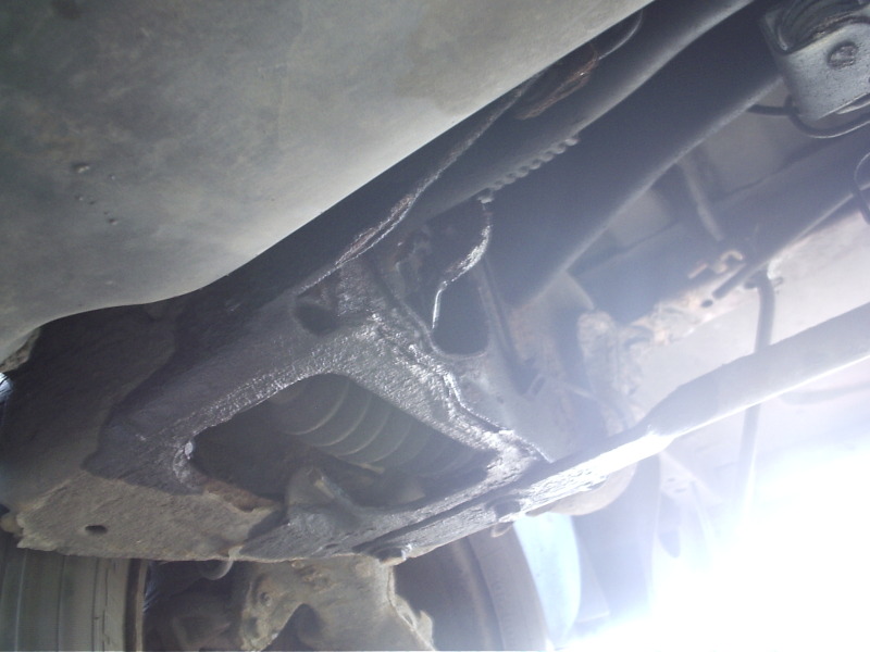

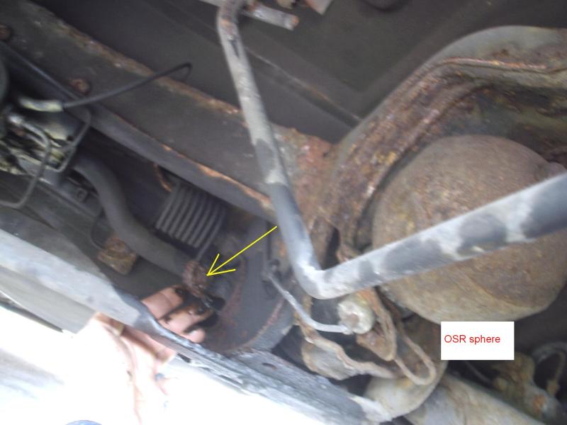

She's leaking from (looks like), behind this bracket:

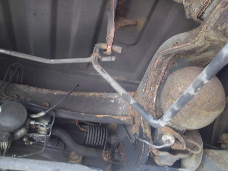

Seems to be leaking from behind that 'holdy on bracket',I reckon the pipe's corroded.(although it looks better than my ww II sphere grenades..which seem dry!
What do you reckon fellas?
a) Can you get that section of curly pipe,gsf etc?
and where do the ends go to,I can't make it out..yet.Anyone a pic/schematic
b) Why is it curly! does a replacement have to be?
c) Can I use brake pipe,fittings,from the factors?
Oh,and what pipe actually is it? I'm guessing the suspension,but could be a fancy brake pipe (blardy foreign thang ) for all I know!

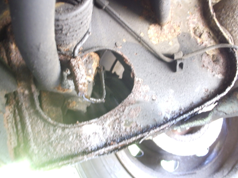

looks like the brake pipe, it will run inside the subframe and down the trailing arm to the calliper, if the pipe goes over the subframe just drop it down, you may find it joins up there, pipe and fitting can be made to spec by plaeides (think thats how its spelt).

it is ment to be curly as its a brake flexi pipe, and yes you must replace with the curly's,

Don't even think about wasing £70 on a steel OE - you won't be able to fit it in any case! Note, you probably can't buy one from the factors, as it needs a Citroen flare on the end, not a std one, and most won't have the tools to do it.
