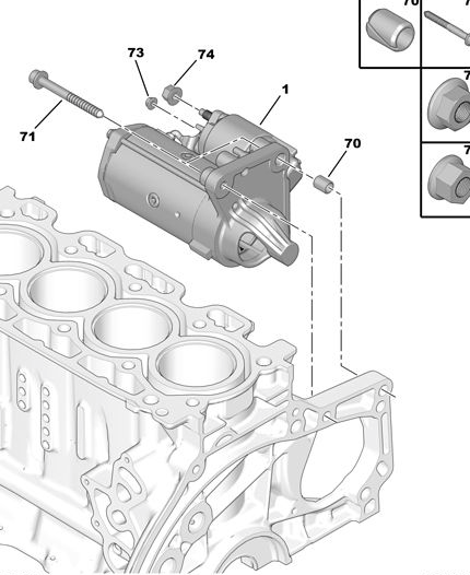

Unfortunately, there's no details on removing the starter - but these are the parts diagrams in case that gives you a clearer picture of the fixings....

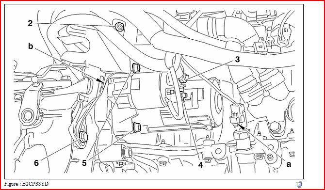

This pic suggests removing the bolt at 6 and nut at 2 - although it doesn't then go on to say to remove the bracket or anything...

I removed the starter motor (Valeo) but there was no dowel fitted. It appears the replacement unit doesn't include a dowel. I wonder if its required?
wheeler
Posts: 7931
Joined: 21 Sep 2002, 19:07
x 1055
Re: C3 Starter Motor Replacement
Unread post by wheeler »
The dowel is not normally included with a new starter, you swap it over from the old one. Are you sure its not still stuck in the engine block?
If its meant to have a dowel then yes it need to be fitted, if not fitted it may move & cause the gear not to engage properly.

wheeler wrote: 11 Jun 2021, 16:20 The dowel is not normally included with a new starter, you swap it over from the old one. Are you sure its not still stuck in the engine block?
I put a new clutch in the wife's C4 1.6 HDI a few weeks ago, and that dowel gave me some grief, I didn't realise it was there when I removed the starter and then the gearbox. after refitting everything the starter didn't engage the flywheel properly, I thought some shrapnel had found its way into the starter from the failed clutch thrust bearing, so off with the starter again, stripped and cleaned it out, refitted it but just the same, removed it again and sat with it while looking at a parts list to identify the correct one, ( I had decided the starter drive gear was at fault)... I saw the dowel in the picture, it wasn't in the starter, and I found that the dowel had pushed all the way into the gearbox so that it was flush with the casing and not locating the motor properly, After pulling it out and putting it in starter first....Job done. lesson learned... that dowel if needed is only about a pound
