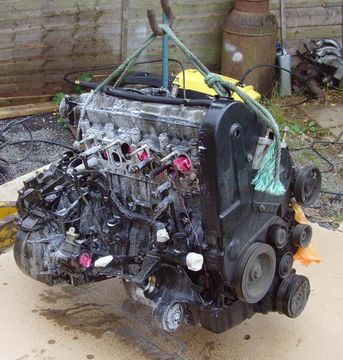

jgra1
(Donor 2021)
Posts: 4625
Joined: 27 Nov 2005, 19:07
x 36
Re: Attempting a cam belt change
Unread post by jgra1 »
a few pics from my td
