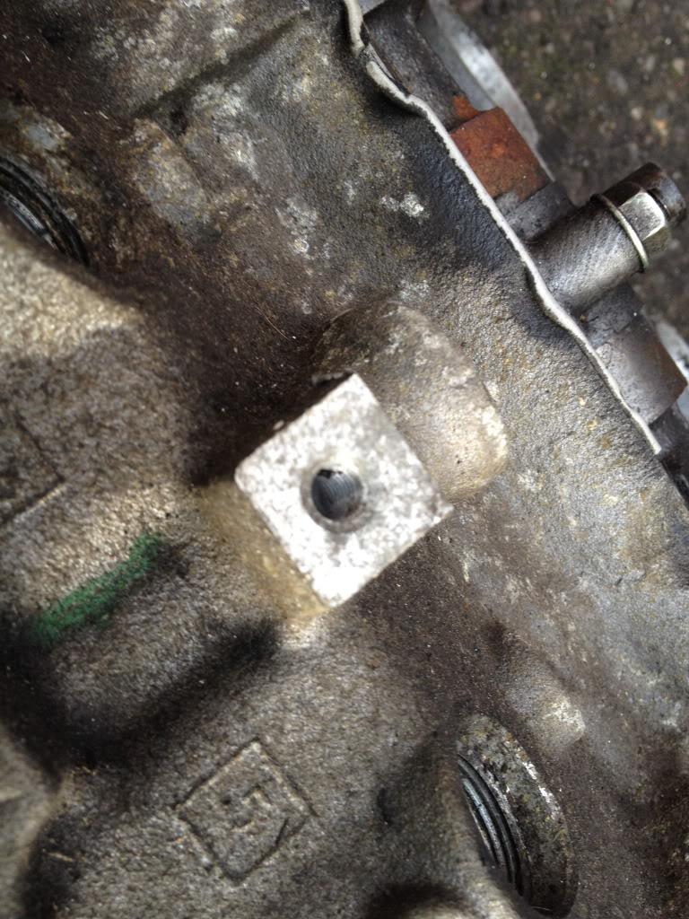

Hi, related to my other post about a water leak from the head.
There is a square lug with a hole in below the middle bolt on the front of the head. I suspect this hole leads straight into the hole the bolt goes through.
Can somebody confirm please. If it does then I'm pretty certain my head is cracked and water i coming up the bolt hole :-(
pic below, scroll down, you'll see the rusty water residue where its exiting the hole.
Barry.

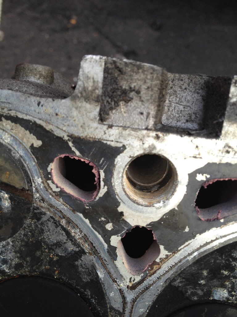

Lighty
Posts: 1103
Joined: 07 Jan 2012, 16:53
x 35
Re: does anybody have a dw8 head they can examine
Unread post by Lighty »
Ok , had a look at the head, and basically ,yours must be cracked, because that lug is directly in front of a stud hole, and that has a water jacket both sides. I have taken a couple of pics if they help
This is what it looks like from the head face, that you cant see with the head on

barrydoran
Posts: 21
Joined: 20 Dec 2010, 12:18
Unread post by barrydoran »
Cheers Lighty for being the bearer of bad news ;-)..
Well you live and learn, should have drained it down whilst it was standing.
Scrap man it is then.. I really cant be bothered doing a head swap, specially since its got 190k on the clock something else major is bound to fail as soon as its done!!!
Thanks.
