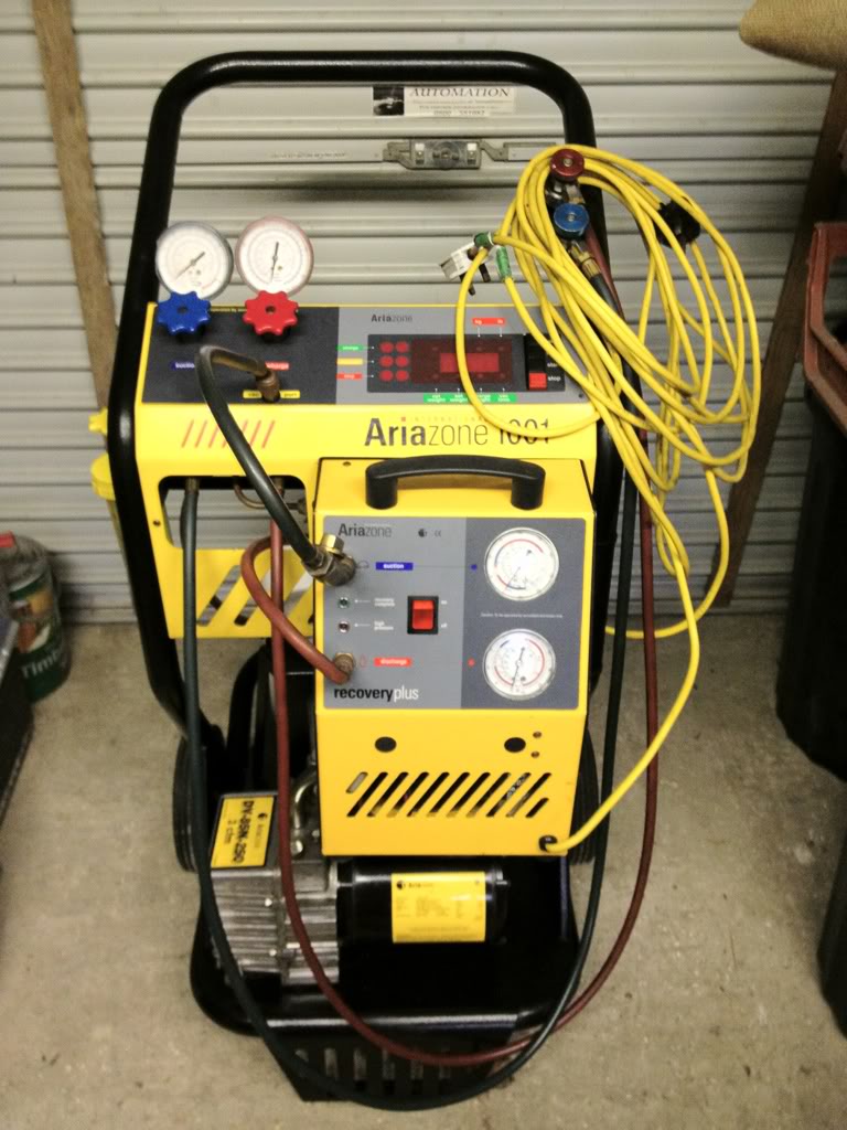

In the hope of fixing the A/C on the SED I decided it maybe better to get the tools together to allow me to do the work myself, that way if it took multiple attempts to find leaks I wasn't going to be paying over and over again not to mention having to take the car in to be fixed. So I bought a A/C recovery and recharge machine via Ebay.
It's an Ariazone 1001 with Recovery Plus module.
