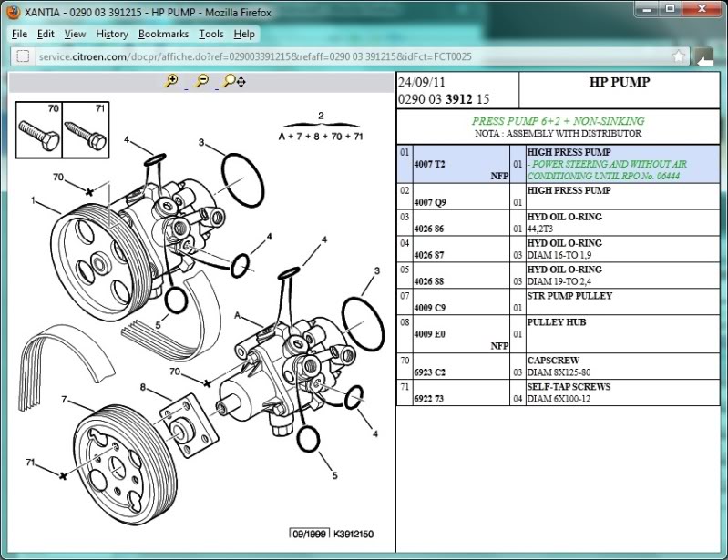

Hi can anyone tell me the size hydraulic pump o ring, its the large one, 36 or 44mm Pt No 402686. Citroen wants over £10, and wont sell me less than 10!
Are these measured in or od?

Re: Xantia v6 hp o ring
I've bought the big O rings for both mine from my local Citroen dealer, for 'only' a couple of quid IIRC individually. Here's their website, I would have thought they could post if Pleiades doesn't come up trumps. Which to be fair is unlikely! http://www.yeomansexeter.citroen.co.uk/
EDIT: Ah, just looked, I'm getting the seals confused. I was thinking of the blanking ones, sorry!
This diagram may help out, whittled down to the Xantia v6:

Thanks lads, I talked to Martin at Pleiades, he was helpful. thinks it`s 44mm x 3mm. Said he can do me a full set of o rings (7) for £35!!!
Thanks for the dia, I was one hour looking for that yesterday.
