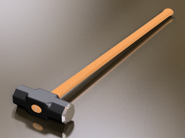

Steve, if I had one of those, i may have used it ;)

Sledgehammer always reminds me of this advert for the Mk3 Cav. I do like Vauxhall's old adverts.
The amount of innuendo in that song :lol:
I guess it is easier with two. Like you say, got to be some give in the strut somewhere.
