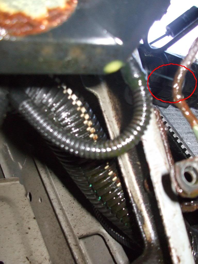

Thank you for your reply's so far, I dont think its split or ruptured as such just worn at its bracket with a slow but constant leak whilst the engine is running as soon as the engine is switched off it stops dripping.
I am not entirely sure how to upload the photo here for clarity purposes.
All I can describe, behind the passenger side front plastic wheel liner and plastic protector is a black coated coil (hydraulic pipe) which is in good condition, running almost parallel is my "dud" rusted hydraulic pipe which runs from a short flexi pipe in front of the gearbox it passes through a bracket with 3 bolts through the inner chassis/inner body then goes up over the end of the gear box to I suspect the valve block (but will look tomorrow in better daylight to check its destination).
The point of pipe failure is where the pipe bends out above the bracket (attached to the inner wing area, which the pipe is really corroded) and the pipe beaneth the bracket and rubber protector is okay but it is illegal to cut out a defective section and replace a short section with new?
would someone point me in the right direction regarding details of pipe diameter, the size of the olive/flare and is it only main "stealer" that supply the rubber seals to seal up the pipework, any photo of a Xantia Mark 2 pipe flare and sealing rubber would be greately appreciated as I suspect my flaring kit will not be adequate on this car due to the presures involved, if someone could help me please.

KevMayer
Posts: 1051
Joined: 12 Sep 2003, 22:01
x 2
Re: Hello Everyone! Newby needs help and advice
Unread post by KevMayer »
There's a topic in the 'Supersticky' section which describes how to put pictures up for us to see.
here's a link http://www.frenchcarforum.co.uk/forum/v ... 19&t=35470" onclick="window.open(this.href);return false;
Please have a go. We like pictures.
Cheers, Kev

avamotor
(Donor 2022)
Posts: 110
Joined: 25 Jan 2012, 21:38
x 2
Unread post by avamotor »
Thanks for the photo info, please find hopefully a photo of the offending pipe.
Advice or help gratefully recieved!

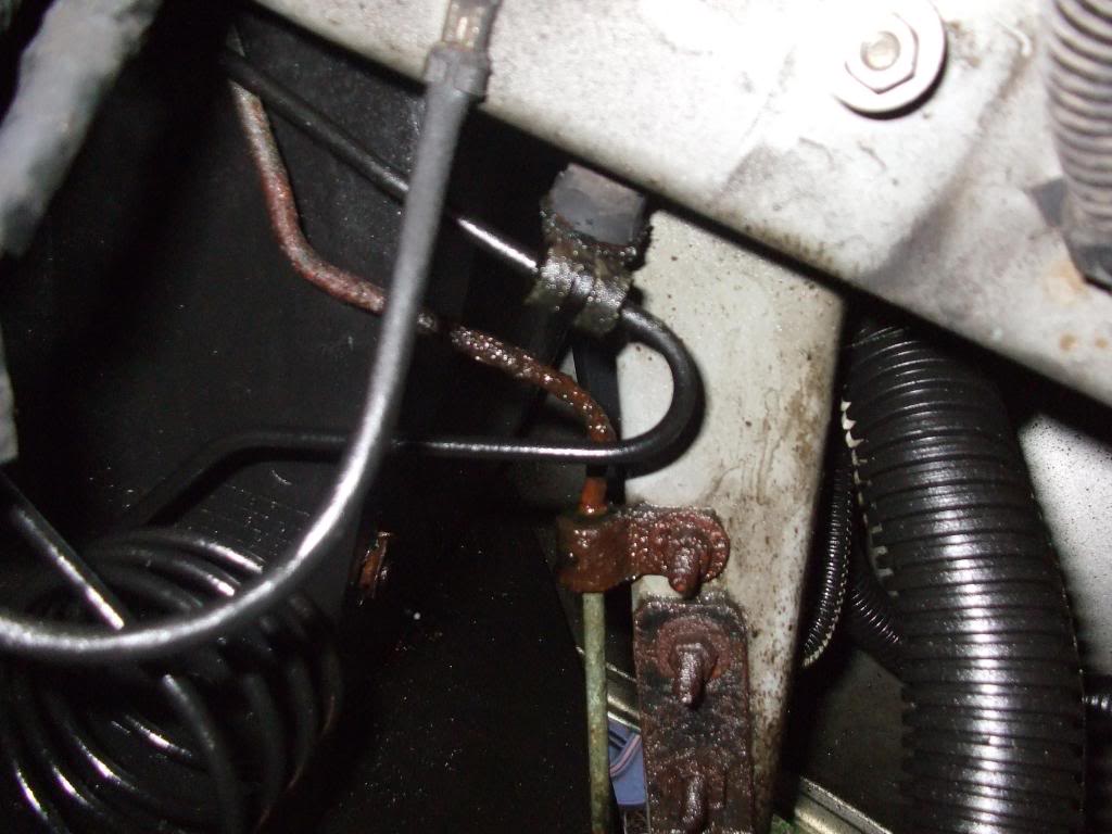

Hello and thank you RichardW, having been out this morning and dismantled some of the car, I have traced it from the belt driven pump (the second pipe furthest away from the pully wheel) and as it dips and bends around various engine ancillaries this is indeed the offending pipe, but I cannot yet find the end!! where at the back of the gearbox around the PAS mechanism does this end? is that bit difficult to get to?
I have uploaded a photo at the point of its leak/failure, is this a high pressure hose or could i cut out the worst affected section insitu and using a rubber pipe (from a Peugeot 405 power steering system) and jubilee clips make a temporary repair?
Or are the pressures involved far too high?
Picture link below:-
can these things be repaired successfully or is it a case "another" from the scrappies?
Unread post by RichardW »
It goes to the pinion valve on the rack, which is where the steering column joins on - hence it goes around 3 sides of the engine bay. Unlikely you can repair it with rubber hose and jubilee clips - you might getn one off a scrapper, but note there are differnt ones for different engine / box combinations. If the rest of the pipe is sound then you could get a new secion brazed in, otherwise, Pirtek or similar should be able to fix it.
pipe was repaired by pirtek and reffited tonight in freezing tempertures but its all good and working.
Thank you for your help and advice.
