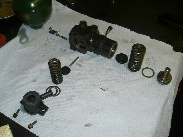

Unread post by Deanxm »
Ok in that case this may help you
CIMG3065 by Deanxm, on Flickr.
A good few of us have stripped the regulator and rebuilt them now as they suffer very badly from low pressure output which makes a massive difference to the operation of the car.

Posts: 84
Joined: 26 Jan 2012, 14:56
Re: Xantia system pressure
Unread post by robin92 »
were is low pressure output? :O
And what you make for rebuild regulator?
