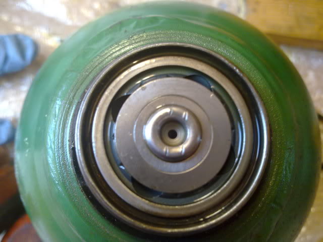

Picked up a load of spares recently and there were some spheres included.
Ive pressure tested them and most are the usual hydractive ones between 30 and 45 bar.
So they will get saved and the duds scrapped.
But one of them I dont recognise, this one pumps up to 70bar and then I can pump no further!
Any ideas??
Cheers
Dave

Well, that's a corner sphere Dave as it has a damper element in it.. The hole looks bloody enormous though...
Is it really pressurised at 70 bar or is it ruptured... Miond you on my tester I can wind the pressure in a ruptured sphere off the end of the gauge although by then the pump is getting jolly hard to turn...

i spoz you havent got a part N. then Dave
regards malcolm

ps.
try this if it works
http://cx.podolsk.ru/xm/docum/citroen_kule.pdf" onclick="window.open(this.href);return false;

No part number, Im sure its not ruptured, it doesnt behave like other ruptured ones Ive tested.
I wonder if its a cx one?

If it was ruptured the pressure wouldn't settle @ 70 Bar, it would continue to rise.
Is there a make shown on the sphere?

The only markings are 75 and w4.

Corner sphere for a Tissier or similar?

Could be a 75 bar CX (maybe comfort) sphere.
