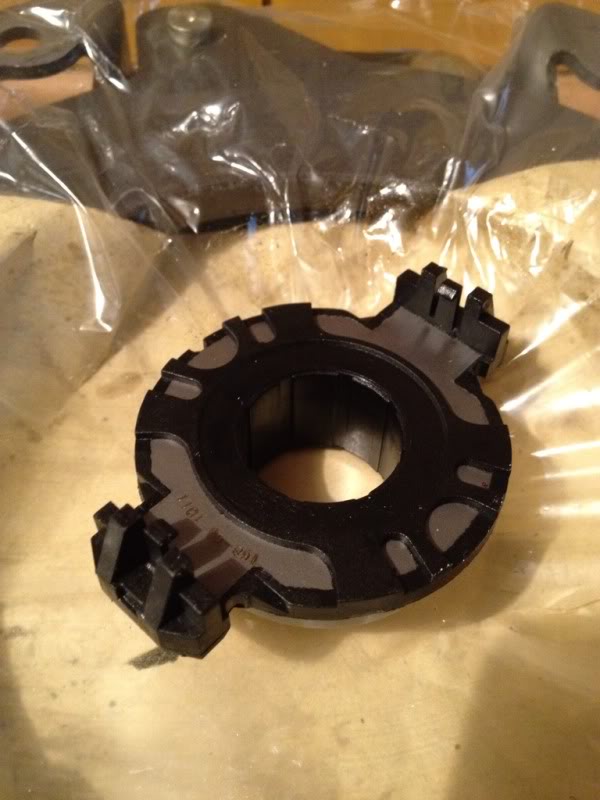

Well the clutch they have sent looks pretty much like a standard clutch and release bearing. The bearing has what appear to be two little 'ears' but i havent opened the packet to look properly.

Sounds like a pull clutch then; confirm it is by seeing the release bearing is captive to the diaphragm spring...

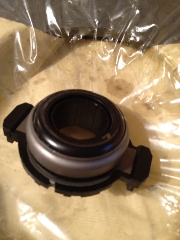

Re: Greetings..and help??
and
Hope they come out

That's a conventional push clutch. Easier to do The ears simply clip on to the release arm forks. You can see the little 'tangs' on the ears.
The notes hold good, just ignore the bits about lining up the release bearing and engaging the forks.
I've just checked and that is the correct clutch for the SD.

make sure those ears sit properly Andy.. i have pulled out a newish, destroyed clutch, due to the ears coming off the fingers and melting themselves silly

the way to tell which clutch is in you car is, if the inner cable at the gear box end is fitted to a fixed/stationery bracket and the outer cable attatched to the fork actuatting lever, this type is a pull clutch,
if the inner cable is attatched to the fork actuatting lever it is a conventional push clutch as your picys show,
as you say you car is a non turbo it should be as your new clutch kit a conventional push clutch,
regards malcolm
