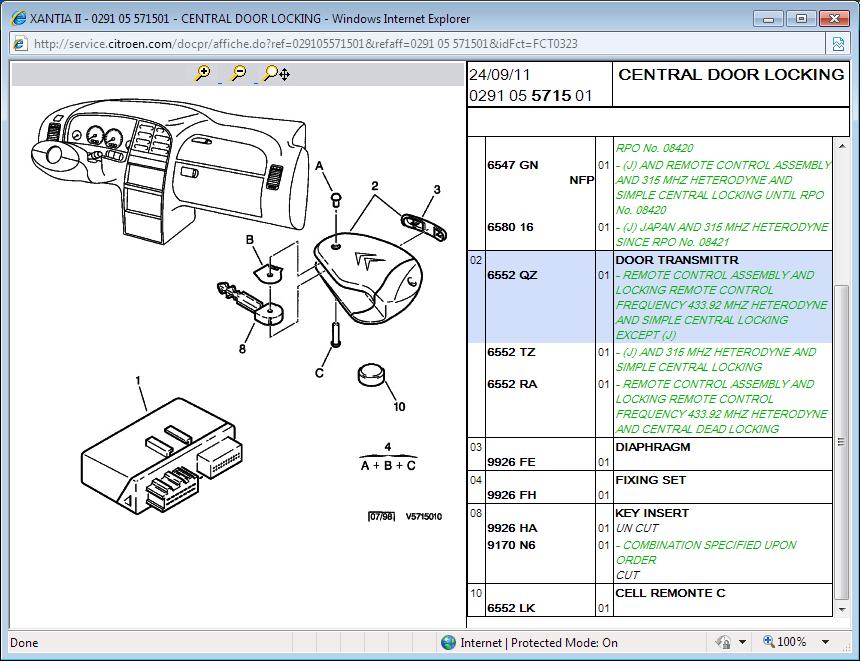

Here we go Nige, the full works...
The PLIP you will need will be 6552 RA for deadlocking. The J type is for the Japanese market as they use a different frequency...
Hope that's OK...
Hope that's OK...

I had my new key blank (9926 HA) cut by a locksmith today.
Programmed up with the Lexia a treat...
I now have a good spare
