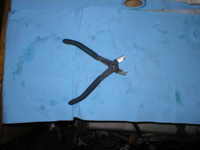

Thanks Jim, does the tool that undoes the pipe clips have a name? thanks again Terry .

I've no idea Terry, All I know is it's a Laser Tool and it looks like this...froggy wrote:Thanks Jim, does the tool that undoes the pipe clips have a name? thanks again Terry .
Halfrauds do/used to stock them. It was about two years ago now I got mine. To me it's an indispensable tool...
