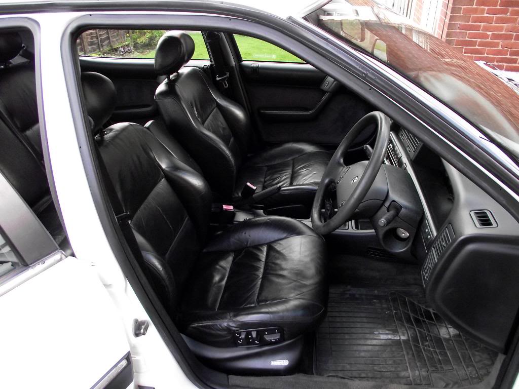

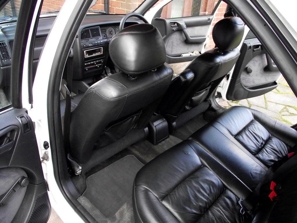

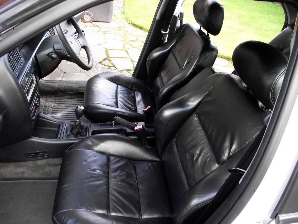

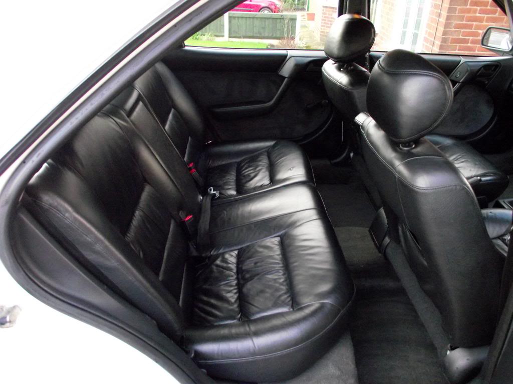

A few photos:

Nice job... If I had a choice I would take the series 1 leather over the series 2

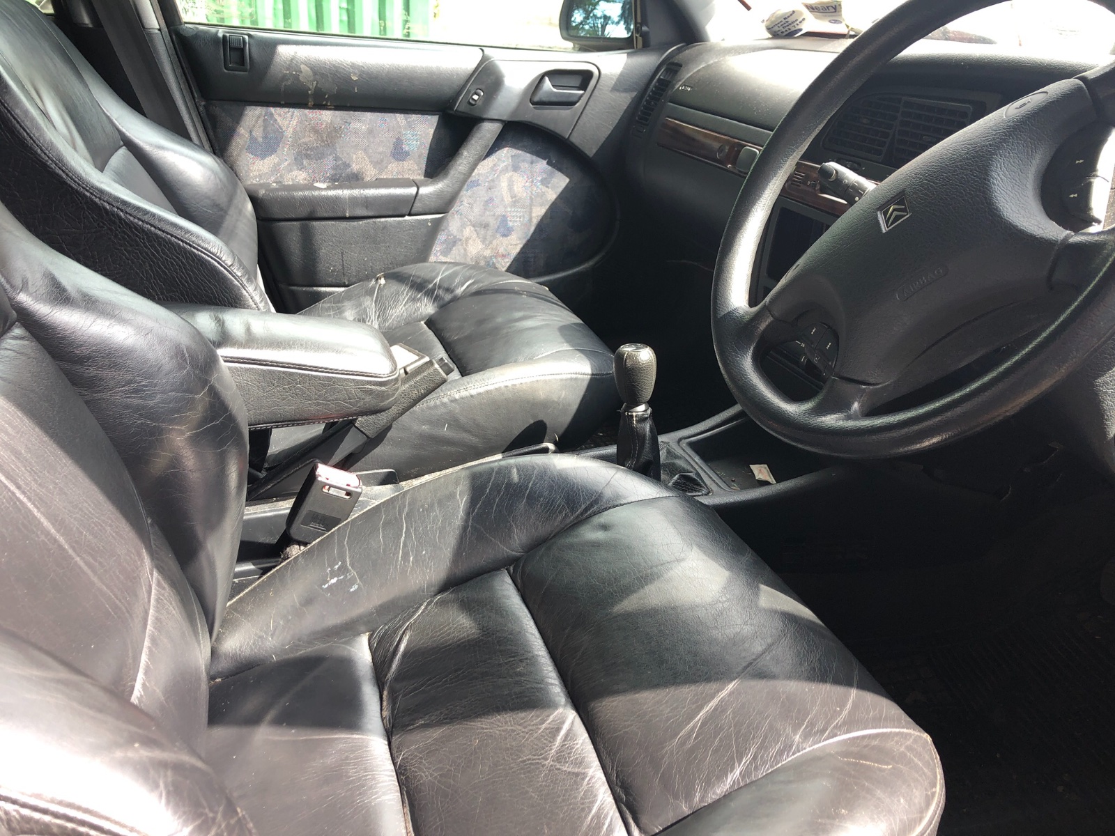

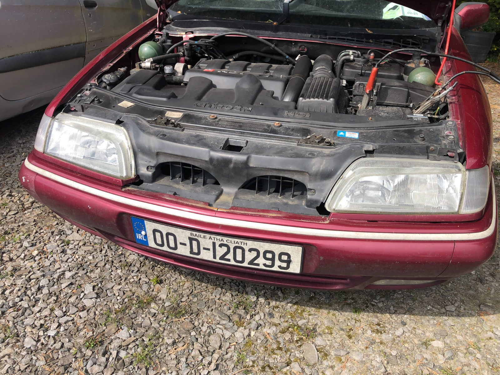

I was offered a 2000 Xantia HDI SX with full leather (electric) seats as a donor car - alloys and useful for lots of spare parts - will the seats transfer over to my other 2001 Xantia - non leather car without too much “surgery”
Thanks in advance

If both cars are the same the seats will swap quite easy not sure if you will have the loom fitted for the front seats but you may have.
Estate rears do not fit in a saloon or vice versa i believe.
Door cards & dash trim will swap over nice and easy also.
