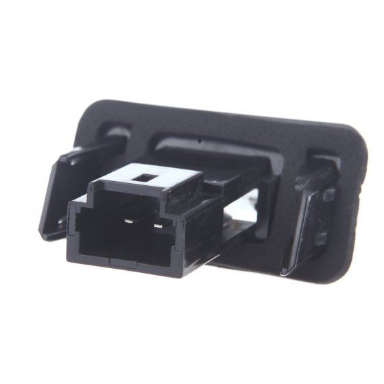

Old thread, but just in case anyone stumbles upon this thread trying to find out how to change a Xsara numberplate bulb, I did one of mine not long ago. The handbook is useless at it shows a screw next to the lamp which simply doesn't exist. The lamp is held at either side by a plastic lug. I used a flat screwdriver and slid it behind the lamp at one side which allowed me to pull that side out of the tailgate. then repeated on the other side. Once off the car getting to the bulb is a lot easier.
Here is a picture shamelessly nicked off the web to show the locating lugs.
