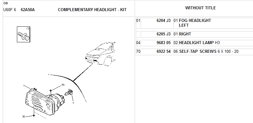

Hmm OK perhaps not. They are 806 ones you have yes ? I looked at front bumpers too although there's a choice it seems to be with / without headlight washers really nothing to do with foglights. There's a note on it that says "bumpers with additional lights to trim plug" , but that's it. I take it that means you might need to enlarge them..

aye there actually from a `96 ulysse , but the part number is the same as pug/cit ones anyway for replacement (mines a 98 806);
what i dont get is that i will need to cut some more out to make them fit - didnt have to do this with a 306 i had years ago
thank you for the diagram

Viewed from the outside , the driving lamps are slightly shrouded by the bumper - so 100% of the lens isn't visible ( nor does it need to be ) as the lamp assy fits from the rear , since it fits flush up to the rear of the bumper it gives a much neater appearance than having a gap around the outer rim of the lamp.
Don't now exactly how the lamp assy fits , or if the fittings are there in different model permutations ? but it would certainly involve removing the wheel arch liners . Which may be advisable in the first instance to see if the fittings exist before chopping holes ?
My daughter managed to replace a bulb in one of mine by wangling her smaller thinner hand in from under the bonnet - but it was a right PITA. removing the arch liner may have proved quicker .
