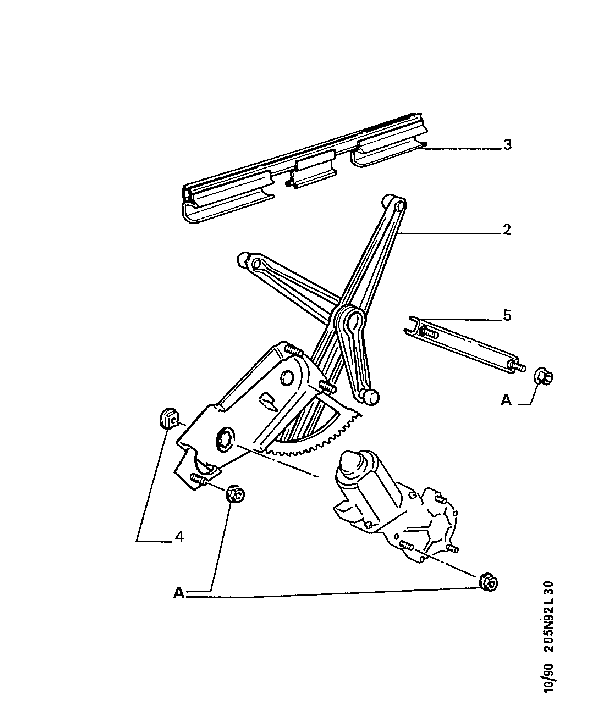

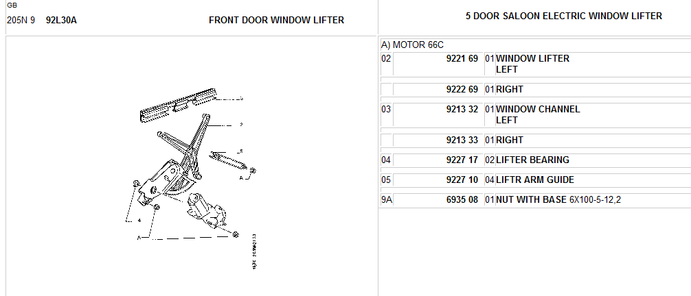

Mine used to work fine, although I have changed others a long time ago I personally did not have many problems apart from slight seizure. Is the horizontal channel (underneath the glass, item 3) OK ? and the guide too (item 5)
My initial suspicion is item 5 (the guide) is bent / corroded or misplaced and as the assembly needs to slide along it. Difficult to explain but 2 is not sat in 5 or 5 is damaged, but easy to see hopefully:
Parts etc:
Bigger parts pic:

If the 'balls' in the end of the regulator are worn it can tip too, if there's corrosion clean them with emery paper etc although they might be too worn if they are corroded. It needs to be a decent fit but not too tight no too loose. I'd suggest dismantling it, greasing it and putting it back together again, you can adjust the guides by bending them closed a bit more but that's a bit hit and miss in most cases.
