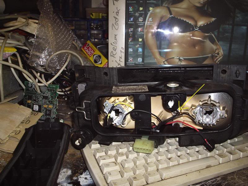

Here's a spare light I got with the car,so I can compare..still don't get me any more room int thengine bay though :lol:

I seem to be distracted by something in that picture you posted :lol: :lol: :lol: :lol:
The usual problem with the lady in the picture, sorry sidelight, is that they melt their holders a little and get very tight in there.
To be honest I'd just whip out the headlight.
Easy in a series 2. Pop out the indicator, undo the torx holding the edge of the under-headlight trim, remove the fan cowl and unclip the other end of the trim and remove. Undo three bolts and the headlight is all yours in your hand.
Much easier than struggling trying to get the bulb out in-situ...

I was thinkin the same meself Jim,light out. Daft ain it..for a sidelight! Might jus whip battery off?
