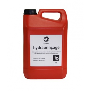

I'd also get hold of some Total Hydraurincage (what we call hydroflush) and replace the 10W50 ASAP!
Make sure you bleed the brakes too!
Run on the hydroflush for 1000 miles, then replace it with new LHM+
