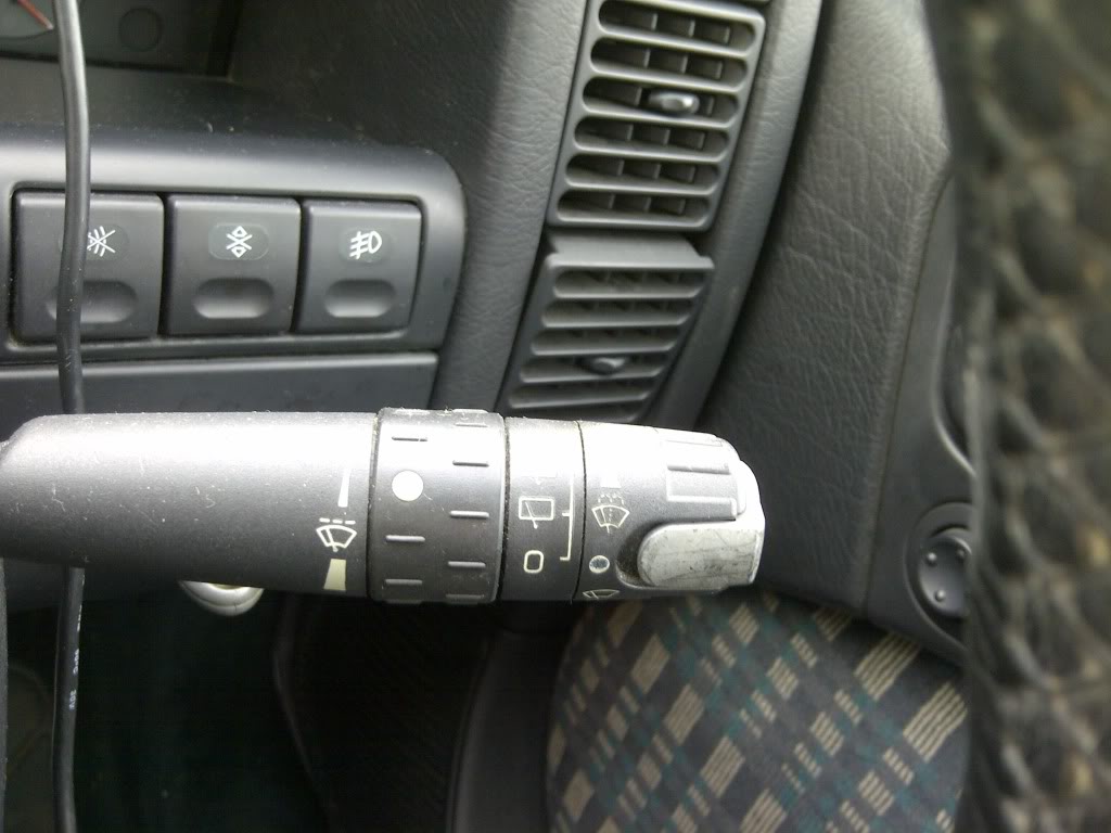

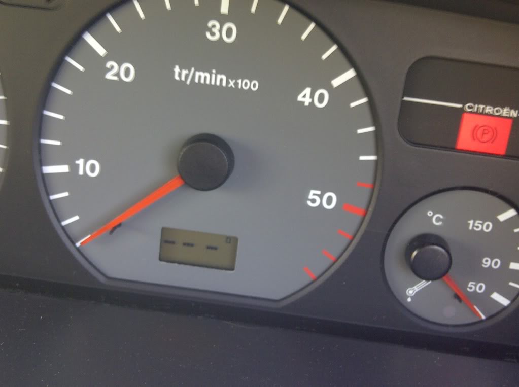

its had a kenwood head unit fitted, so the volume controls ect doent work, the problem is that niether does the trip computer< i take it that the button on the end of the wiper stalk is the trip button>

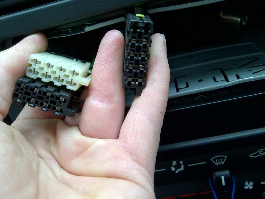

so i removed the head unit and found an empty socket, wondered if that was maybe why its not workin ?? anny advice would be great :)

Looks more like an oil temperature display to me, is that a degrees symbol in the top right corner or an A/B?

hey guys, well i thought it was a trip computer,it's a little square in the corner, cant be oil temp cos the oil temp gauge is right next to it :)
clocks in the centre console so i cant think what else it could be except a trip computer ?

The display is the one for outside temperature... The dashes acrooss it mea the sensor is duff/broken/not connected...
I can't now remember which door mirror the sensor is in but I know it's opposite sides depening on whether it's a MK1 or a MK2. However the presence of the sensor can be felt by feeling under the mirror hinge. The sensor will be felt as a round bump.
Often a mirror is replaced and replaced with a non-sensing one... Only the VSX, MK1 Exclusives and Activa models had this display and sensor so any mirror got from say, a scrapper, is likely not to have it...

Its as Jim states, trip computers were never fitted to Xantia's, well at least in the UK.

oh dammit i was hopeing for a trip computer never mind :(
the drivers side wingmirror has been replaced so it must be in there.
now i can stop hopelessly clickin the button on the end of the wiper stalk hehe

Yes on a VSX the sensor is under the O/S mirror, mind you I can't see any reason why you couldn't fit a sensor to the mirror as I think the panel that'll be there ATM can be flicked out and replaced with a sensor which are available separately, after all the rest of the wiring is there.
